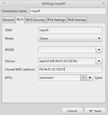

I was having this issue when closing the lid of my laptop (entering 'suspended' mode). Once I opened the lid, wifi refused to connect and I was getting [ 183.188182] wlp60s0: failed to remove key (1, ff:ff:ff:ff:ff:ff) from hardware (-22) in dmesg. I tried lots of things and nothing worked. The only thing that really worked for me was restarting my router.
I could not fix this issue at all using any solutions given, disabling wifi card options via /etc/modprobe.d/iwlwifi.conf, nothing worked.
What worked for me was changing the MAC address on the actual wifi connection. Somehow something must have been caching that and associating it with some bad wifi / connection state, even after reboot. Maybe it was my router, but it's very weird.
