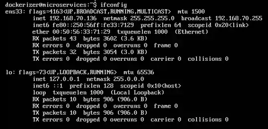

The network interface looks as follow:

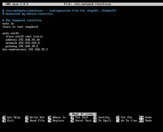

Then, I try to set a static ip address:
Save the configuration, reboot the vm, but still got the same ip address like the first image. Ubuntu does not apply the static ip address.

What I noticed is, that the intefaces file has no entries.
make a look to this link, I think there is a huge change with network interfaces file in server 17.xx version ;-)
https://websiteforstudents.com/configuring-static-ips-ubuntu-17-10-servers/
