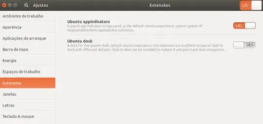

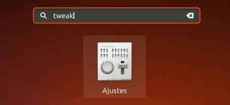

Click the nine dots on your dock.
applications icon
At the search field write "tweak". You will see gnome tweak tools:
searching gnome tweak tools
If you don't have it installed you can click it and that will open software center. You can install it from there.
After, run tweaks and go to extensions.
appindicator on tweak tools
Just turn the appindicators on and you will have a working system tray where you can see the dropbox, telegram or other icons.
