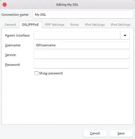

  2. Type nmcli con edit type pppoe con-name "My DSL" it will drop you into an interactive prompt.
  3. set pppoe.username ISPUsername (obviously you should replace ISPUsername with the username given by your ISP)
  4. save
  5. quit

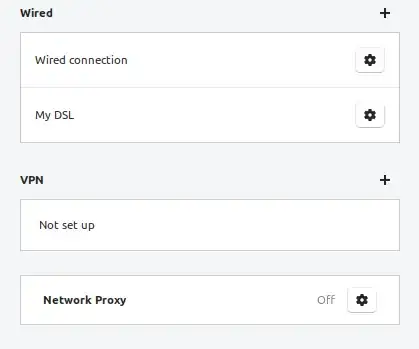

  6. Now you are be able to edit other configuration in Settings > Network and it will now look like this:
Wired Connection
  1. After pressing gear icon you will be able to edit the connection :)
connection edit
