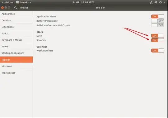

You can get the date displayed in the top bar by using gnome-tweaks (was gnome-tweak-tool). First open up a terminal with ctrl+alt+t and install the tweak tool with
# sudo apt install gnome-tweak-tool # obsolete package
sudo apt install gnome-tweaks # current package
gnome-tweaks # now launch it
After that you can start it from the application selector (there the name is just tweaks) and navigate inside the tweak tool to the tab for 'Top Bar' and activate Date and Seconds (see screen-shot).
