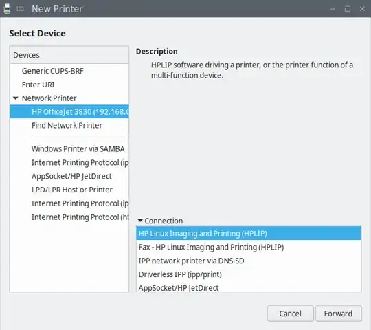

After that, go to Printers section, Add, select “Network Printer”, than select "Find Network Printer" and just wait a bit until your printer appears under there.
Then select "Forward".
You will be asked to give it a name etc.

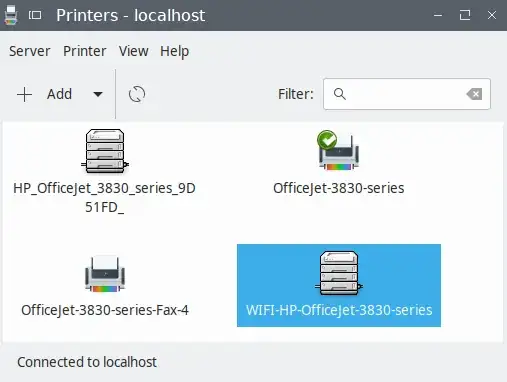

When the process is successful, the "Wifi Direct" printer appears in the list of printers as a different printer beside the USB connected one.
