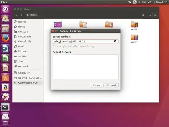

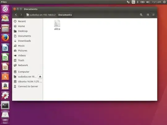

You can use GUI tools, for example the file browser Nautilus or the dedicated tool Filezilla with the text
ssh://user@IP-adress
for example
ssh://sudodus@192.168.0.2
in the box for location of the directory you want to see. You can save it as a bookmark, and manage the remote directory seamlessly.
