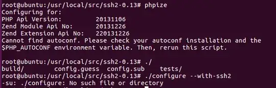

  1. modify the php.ini
vi /etc/php.ini add the "extension=ssh2.so" to the extension part of php.ini
  1. check the environment of php, use phpinfo();
But I fail in step 2: enter image description here
Please help me. Thank in advance.
Liso
  • 15,677
You're missing the package which essential in order to run the script properly, simply install.
sudo apt-get install autoconf
