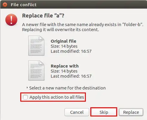

Alternatively, if you want to use the GUI, that is also doable with plain old Nautilus. Just drag and drop the contents of one to the other, and you'll see this prompt on the first conflicting file. Just hit Apply this action to all files and then Skip:
image showing things
┌─[17:01:33]─[kazwolfe@firewolf]
└──> /tmp/xor-gui % cat folder-a/a
Hello World A
┌─[17:01:34]─[kazwolfe@firewolf]
└──> /tmp/xor-gui % cat folder-b/a
Hello World B
