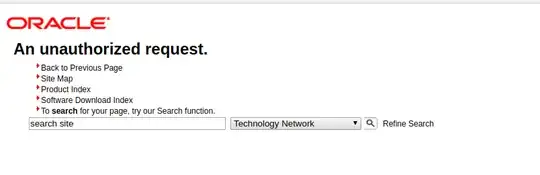

And when I try to go to, say, http://download.oracle.com/otn-pub/java/jdk/9+181/jdk-9_linux-x64_bin.tar.gz?AuthParam=1508359625_bdbf7e44fa803075b290d8fca35d82f8, I get the web page that looks like this:
So it appears that Oracle has gone and broken Linux installations. Or maybe there's something I can do on my end?
