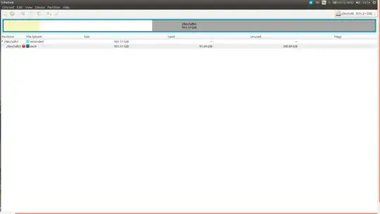

I wanted to increase the hdd space by unmounting and deleting the extended partition sdb1,then creating a new partition...
Now in gparted,I have this:
PIC 2

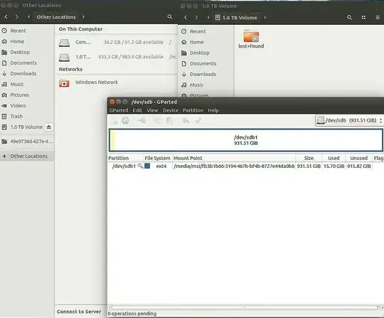

So i wanted to open the hdd from nautilus,but i couldn't open that...
I faced with an error which says:
This location could not be displayed
You do not have the permissions necessary to view the contents of "lost+found".

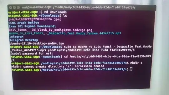

Now,What should i do? I can do nothing from nautilus(copy paste a file or folder or open a new folder in hdd),but i can do anything from terminal with root permission.
Check this: PIC 3
PIC 4

Create one or more directories in your partition using
sudo mkdir directory-name
and change the ownershĂ­p to your regular user ID using
sudo chown "$USER":"$USER" directory-name
Then you should be able to use the directories (in my example "directory-name") as your regular user. In these directories you will be able to create and delete subdirectories and files without restrictions.
