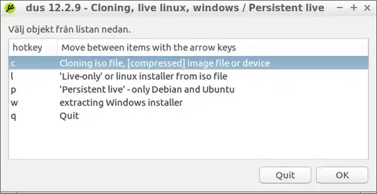

    • mkusb version 12 with mkusb-dus
      If you run standard Ubuntu, you need an extra instruction to get the repository Universe. (Kubuntu, Lubuntu ... Xubuntu have the repository Universe activated automatically.)
      sudo add-apt-repository universe  # only for standard Ubuntu
      sudo add-apt-repository ppa:mkusb/ppa  # and press Enter
      sudo apt-get update
      sudo apt-get install mkusb mkusb-nox usb-pack-efi
