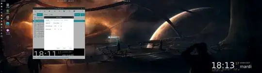

I'm using Conky on Ubuntu 17.10 to display system informations on my desktop.
My computer has 2 monitors and I would like to move Conky to the 2nd one that is on the right, but I haven't found any informations on how I can perform that.
Here is a screen of my desktop:
Any help would be most welcome!

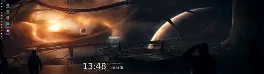

I finally managed to move the Conky widget to the second monitor using negative values for the horizontal gap (-1920) after choosing Bottom Right in Conky Manager. And now my desktop looks like this:
Ubuntu desktop with Conky on a different monitor than the principal one
If anyone has a better solution I would consider choosing it as the accepted answer.
