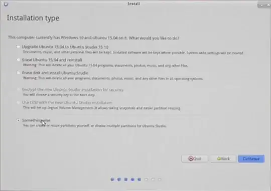

To install a new release over an old release follow the instructions in How do I reinstall Ubuntu?. Because you are installing a different release I recommend backing up the personal data in your /home folder, and then when it comes to the Installation type section of the Ubuntu Studio installer select the option to overwrite the existing operating system and replace it with the new one. Selecting the first option, Upgrade Ubuntu GNOME 17.04 to Ubuntu Studio 18.04, may not work properly because you would be skipping over releases when upgrading.
