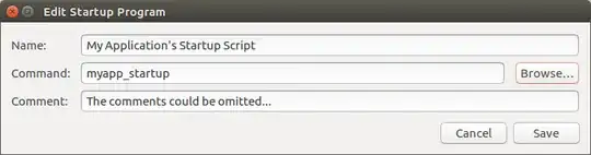

Now we can create an entry in Startup Applications as this:
  • Additionally we can modify the startup script in this way: sleep 3 && gnome-terminal ... to launch the new terminal window after the entire desktop is initialised.
  • When the script isn't located within a directory that is added to user's $PATH variable (echo $PATH) we should use the full path, for example: /usr/local/bin/myapp_startup.
