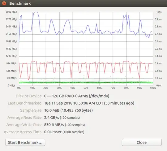

All that remains is to benchmark it:
benchmark ` and create an fstab entry to automount it at at startup.
