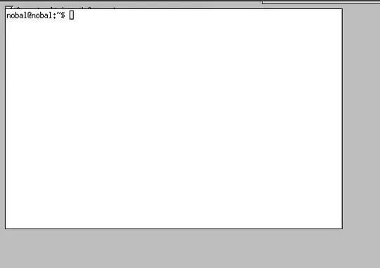

I'm trying to set up vnc4server on an Ubuntu 16.04 (Xenial Xerus) server version system.
I can currently vnc into the computer no problem, but I can't view my running applications - only my terminal. How can I view my running application on the device?
This is what I see:
Terminal emulator with which background and prompt in console font and nothing else

I had the same problem to get a remote graphical access to a Ubuntu server. I ended up to login with ssh to the server, run 'tasksel' and install "Xubuntu". This is the most lightweight variant, since my server has a next-to-no-good-at-all graphics card. After the install your server boots into a desktop. It does not hurt, since most of the time it will remain at login screen and does not eat up too much resources. I did configure my server to not start the X-Server, so I have to do it manually from SSH when I need it with
sudo service lightdm start
When the X-Server (aka the desktop) is running your VNC server actually has something to show. You should see your application as you intend. You could also login from a Linux client with
 ssh -X
Then you are able to get the graphical windows running on the server on your client screen. Then you even might not need VNC and the response times are a lot better.
