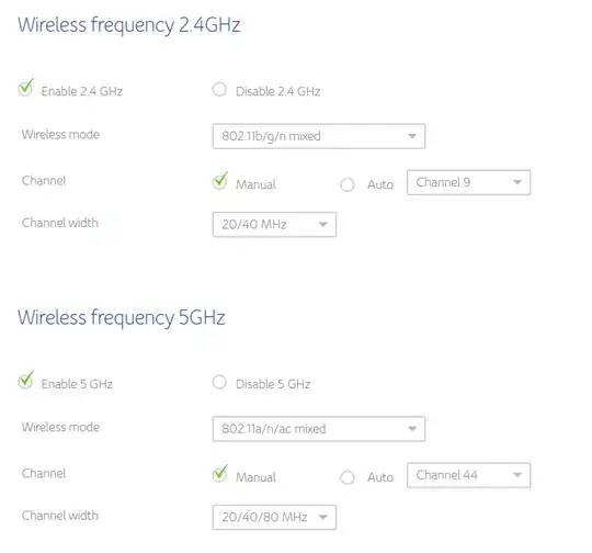

You need to make changes on wireless router and set manual channel select. See the image below
Wireless settings on Router
