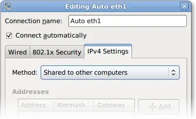

On those releases, it used to be offered like this:
Older releases

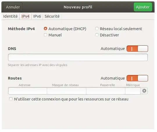

On Ubuntu 17.10 (today's daily) connection sharing is not even offered. See image below.
"Automatic", "manual", "link-local" options shown below were offered previously, though not visible in screenshot above because it was a drop-down box.
Connection parameters do not offer sharing

16
That setting is available in nm-connection-editor (just run this cmd in terminal).
