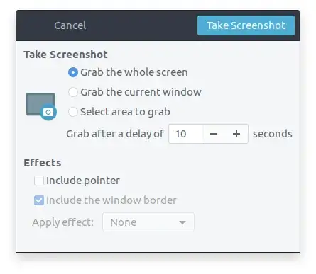

If you run the command
gnome-screenshot --interactive
the following window should pop up:
But if you run
gnome-screenshot
a shot of your whole screen should be saved to your Pictures folder without any delay (but there will be a mechanical camera shutter sound and the screen will blink once).
