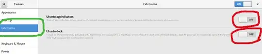

The gnome-tweak-tool can be used to make the top icons reappear.
Install gnome-tweak-tool if not already installed.
$ sudo apt-get install gnome-tweak-tool
Launch it (gnome-tweak-tool from command line, Tweaks if from dock).
Select Extensions from the left menu. As we can see, Ubuntu appindicators is turned off. (You may also want to note that Ubuntu dock is turned off as well.)

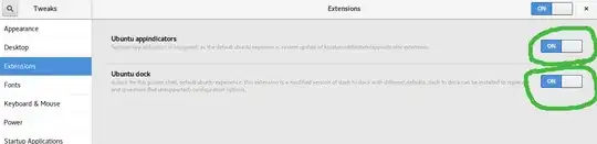

Turn Ubuntu appindicators on. If you want, you may also turn on Ubuntu dock.
The top icon(s) reappear.
And if you turned on Ubuntu dock, the dock is also permanently displayed at left.
