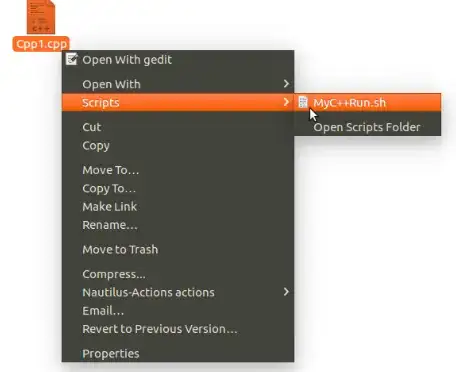

I want to learn C/C++. Here my requirement is not to use any IDE. I want to run my C/C++ program in following way,
  1. I will write "Cpp1.cpp" //which will print "Hello World".
  2. Save the file and close.
  3. Right click on the "Cpp1.cpp" file.
  4. In the right click menu options, I should have a button as "Run C++".
After following above 4 steps, output or errors should appear in the terminal window.
I tried to do using Nautilus script, but it failed miserably after multiple trials.
Please see the screenshot (which is not working the way that I am expecting).
Reference image

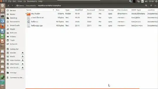

1. Create Nautilus script's file and make it executable:
touch "$HOME/.local/share/nautilus/scripts/MyC++Run"
chmod +x "$HOME/.local/share/nautilus/scripts/MyC++Run"
2. Here is the content of the script. It creates an auxiliary (auto deleted) script, which is executed in a new gnome-terminal, thus you can see the error messages within the terminal window:

  • Here is an example script, that creates a log files, where you can see the error messages from the process.
3. Here is a demonstration (from the previous version) of the script's features:
