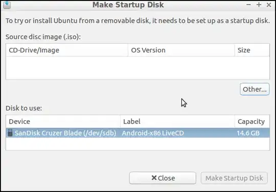

I'm noticing that the Startup Disk Creator that ships with Lubuntu 16.04 LTS has persistent storage feature missing, and does something to the pen drive that wasn't happening earlier. (I have previously the tool in Ubuntu 12.04).

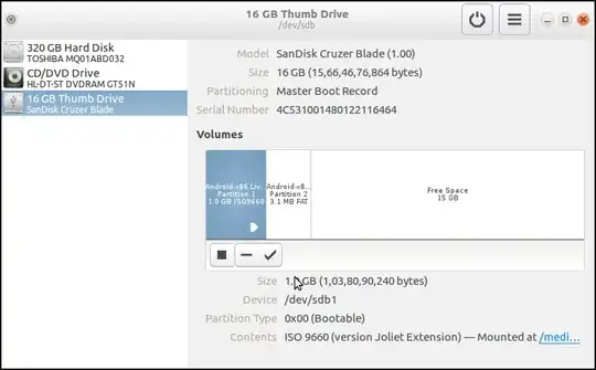

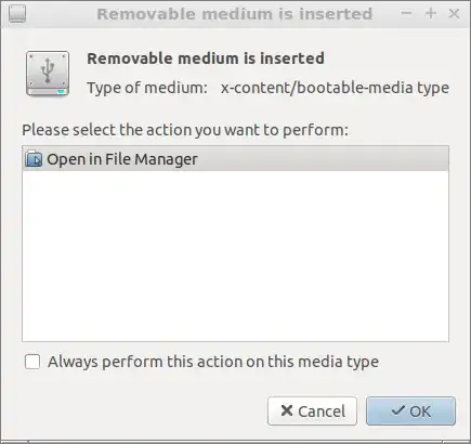

After creating the bootable USB, the next time I inserted the drive in a running Ubuntu OS, it was invisible for a Lubuntu bootable disk, and visible for a RemixOS disk. When it was invisible, I had to open Accessories > Disks and manually mount the drive to make it visible on the system.
In either case, the USB now has a much smaller partition having just the OS, and it's read-only. The remaining space (15GB in my case) is unpartitioned, and if I try to create a second partition there to use that excess space to store my files, it errors out. Both in the Disks utility as well as in GParted.

Addendum: See screenshots of the application from earlier years here.

Edit, 8.Oct.17 : Thank you, good to know there's a solid reason behind the change. Still, the drive goes invisible (not mounting when inserted) when written with a Lubuntu ISO and I think that's a bug. Normal users will simply be led to believe that the USB is toast. If possible, can someone get the program's developers to put this info on the application behind a help button or so? And the program has to explicitly warn the user that the USB will NO LONGER be a USB after the operation; that it will be like a read-only CD, that all excess space will be rendered unusable by this operation. At present the lack of even a help button on the application is deceptive. Also, I don't think the removal of previous buggy nature has led to a solution. I'd call this a taking a step back until the matter is resolved. If anyone can suggest where I should go to file these issues so that the developers involved can be reached, that would be great. Thanks again!

The old Ubuntu Startup Disk Creator was extracting the content of the iso file and trying to create a boot structure. It was notoriously buggy for years, because it was affected by modifications of the boot system between different versions of Ubuntu.
At the same time all the current Ubuntu iso files are hybrid iso files. It means that they can be used to burn DVD boot disks as well as to clone USB boot drives and memory cards. Cloning is a very simple and reliable process, where every single byte is copied as is from the source to the target.
So a new version of the Startup Disk Creator was developed and introduced with Ubuntu 16.04 LTS. This version is a cloning tool. The resulting USB boot drive will have an iso9660 file partition table and file system, which is read-only. Therefore it is not possible to make a persistent live drive with this method in Ubuntu 18.04 LTS and previous versions.

Question 2: How do I fix this and get the older Startup Disk Creator back?
Answer 2: Don't try to get the old and buggy Startup Disk Creator back.
2.1. Standard case: Live-only
I would recommend that you use the current cloning Ubuntu Startup Disk Creator, when you want a live [live-only] Ubuntu USB drive or simply an installer (to install Ubuntu into another drive). This would be the standard case.

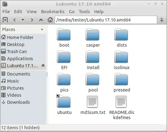

  • I have checked in my working environment, 16.04 LTS and a testing environment, Artful Aardvark, to become 17.10 during this month (October 2017).
    • The main partition of a cloned USB drive of Lubuntu 17.10 amd64 will be automounted in both systems.
    • But nothing will be automounted, when I plug in a corresponding cloned USB drive of Lubuntu 17.10 i386.

      sdb    iso9660  3,8G Lubuntu 17.10 amd64
      ├─sdb1 iso9660  918M Lubuntu 17.10 amd64 /media/tester/Lubuntu 17.10 amd64
      └─sdb2 vfat     2,3M Lubuntu 17.10 amd64

    I don't know why there is a difference between these two cases, but I know that Ubuntu's developers are focusing on the amd64 architecture. They will stop releasing i386 desktop iso files. But Lubuntu and other community flavours intend to continue to maintain and release i386 (32-bit) versions and release i386 iso files.
