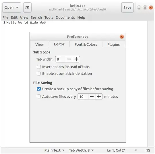

2. Alternative - let the editor do the job automatically
Some editors have an option to create a backup copy of the file before you save a new version. This backup has often a tilde as the last character (tilde is the extension, but there is no dot before it).
Gedit, the standard editor in Ubuntu is one of them.
After setting gedit to save such a backup copy:
gedit hello.txt
And check afterwards
$ ls hello.txt*
hello.txt  hello.txt~  hello.txt.bak
Now hello.txt~ has been added to hello.txt and the backup created by bupper.
This works with nano too, with the option -B
nano -B hello.txt
so you can do it with a command line editor for 'sudo' tasks :-)
