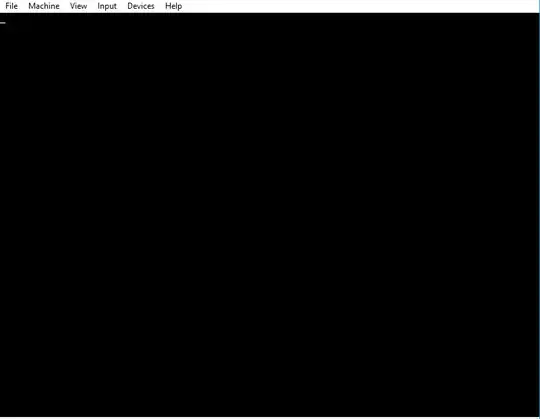

I am using VirtualBox with XUbuntu 16.04. All was going fine before I install guest additions, but after the install, the OS doesn't start. I think it is the boatloader that fails (btw I am noob at Ubuntu, and I read that's called by GRUB2). The only way that I can start Ubuntu is going to the 'Recovery Mode' and then start it there. That is what happens when I turn on my VB:
Ubuntu won't start.

Been looking for a solution to this for a while now, finally found it here:
https://askubuntu.com/a/726285
Basically:
  • Append nomodeset to GRUB_CMDLINE_LINUX_DEFAULT in /etc/default/grub (after quiet splash)
  • Run sudo update-grub
  • Should reboot normally now.
See here for an explanation of what nomodeset does (shouldn't have an impact once booted):
https://askubuntu.com/a/207177
