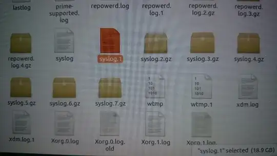

I realized that there is a file named:syslog.1 in /var directory. the size of the file is: 19 GB, so I think this is the problem! but can I delete it? What happens if I do that?
Image from /var/log/syslog.1:
file browser open on /var/log directory

You've got a stuck key on the keyboard. The stuck key is generating failed login requests that are filling up your logs.
Unplug the keyboard and use an external keyboard to prove this. This goes for both laptop and desktop machines.
ps: don't delete the syslog and syslog.1 files until you've reviewed them, as they're your only record of what went wrong
ps2: you've got a smallish SSD that may not be partitioned optimally. Show me a screenshot of gparted and tell me what's on sda6. Is sdb5 an external disk?

Ok good work, thanks for installing ncdu now all you need to do is clear the /var/log/syslog.1 but there is a special way to do this, do not delete the file because the file is needed and even if you create it manually, it will have the incorrect permissions. According to this link you can clear a log file with the following command:
> /path/to/log-file
example:
> /var/log/syslog.1
but before that, you must become root as with sudo it will not work. To temporarily become root you need to run the following command:
sudo -s
then you just run:
> /var/log/syslog.1
and that should do it. It will clear the space. Although this is not the proper way, it does the job. Please make sure you read the link I provided, it talks about log rotation, you need to rotate the logs rather than clearing them.
P.S. I just ran > /var/log/syslog.1 on my Ubuntu 16.04.3 and it worked fine.
If this answer helped you, please click the 'Accept` button.
Oh BTW, run sudo apt install shutter
It is a snipping tool that you can use to take screenshots.
EDIT: Additionally, if you want to inspect what went wrong, do not clear the log files as other posters have responded.
