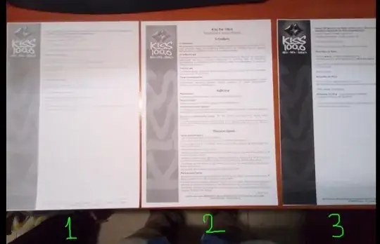

Every time i get the same dark print like the example 3.
I have tried to get the brightness up with Gimp and managed well results. So i believe it's a brightness setting.

Print tests
2 is the desired density (windows). 3 is what gets printed with Ubuntu and Toner Save: OFF and 1 is with Toner Save: ON
