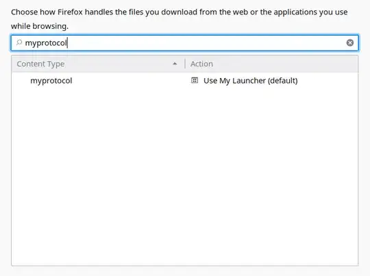

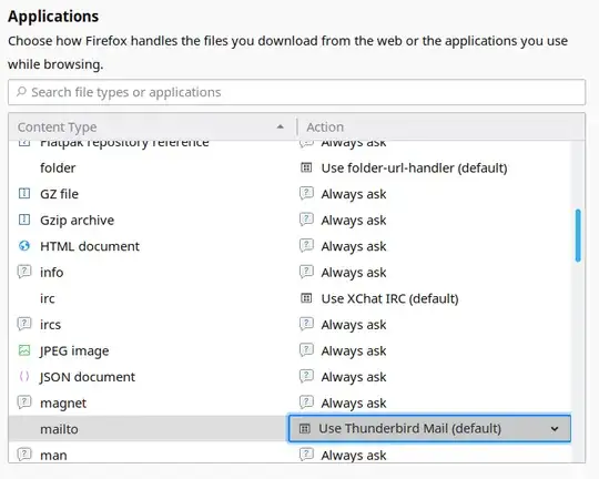

The scheme handler is only working for xdg-open command it doesn't work if I try the same URI on the browser.
If xdg-open is working, then it's just a matter of configuring the browser. Based on your comments, it looks like you are using Firefox, which handles this under Preferences:
Choose how Firefox handles the files you download from the web or the applications you use while browsing.
Applications
This is stored in handlers.json, as you mention.

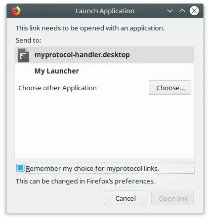

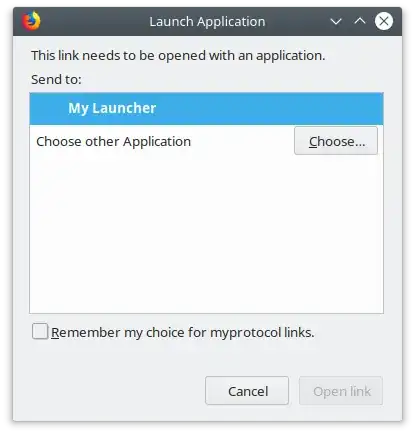

    The first time you open the link, Firefox will prompt you to find the desktop file.
    This link needs to be opened with an application.
    Navigate to ~/.local/share/applications/ and click myprotocol-handler.desktop.
    Also tick the box that says "Remember my choice for myprotocol links."
    It should look like this when you're done.
    Use My Launcher (default)
