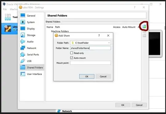

Assuming that we have already added the shared folder in the virtual box:
1) Machine -> Settings -> Shared Folders
2) Click on the "Add new shared folder" icon
3) Choose the path for the host folder you want to share (for example "C:\hostFolder")
4) Give "Folder Name" a name (for example "sharedFolderName")
5) Check "Auto-mount"
However, after starting the VM, there was nothing in my /media/.
