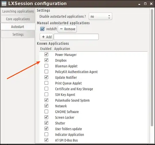

This solution works even if there are several accounts in the computer, because the change was not saved in $HOME folder. To assure dropbox will autostart, check at
Preferences > Default Applications for LXSession
if Dropbox is checked as shown below:
