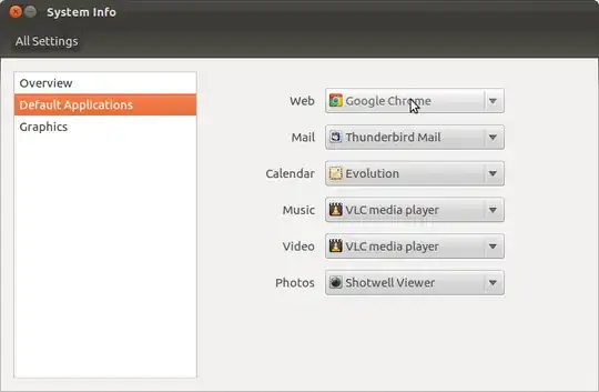

Assuming you are using Unity, click on the dash button in the launcher and search for 'System info'. Then, open 'System info' and move to 'Default applications' section. Then, click on the dropdown list next to Web. There, select 'Google Chrome' and it will be selected as the default web browser for your system.

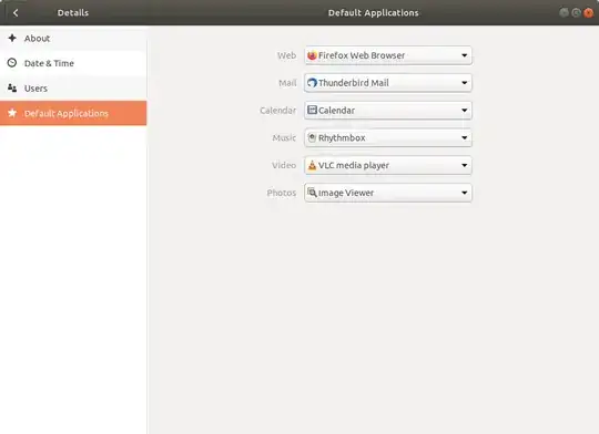

In Ubuntu 18.04 and later select Settings -> Details -> Default Applications.
