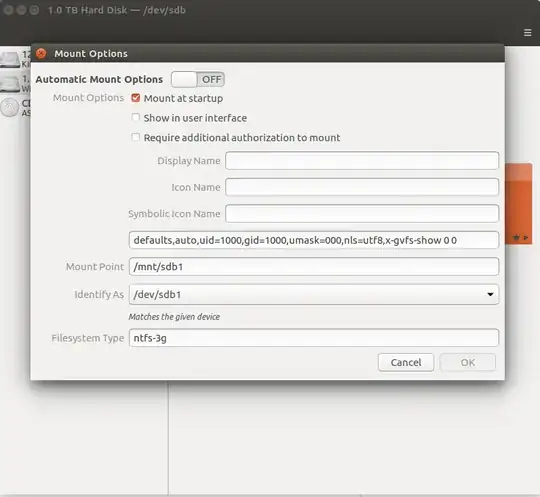

I did use the option of editing the fstab, from the Disks utility in Ubuntu 17.04. (I found my info here.)
It's in the screenshot, but I'll also post my entry to the fstab for reference:
defaults,auto,uid=1000,gid=1000,umask=000,nls=utf8,x-gvfs-show 0 0
I opted for the umask=000 which might be too permissive, but since I have other users using this drive (logging into the same machine as their own users) I didn't want to accidentally lock it for them.
I'm not sure if the uid, gid, or umask made the difference; I had already applied ntfs-g using the Disks utility with no change to the problem, so I'm assuming it was a legacy user issue from when I had to reinstall windows and Linux.enter image description here
