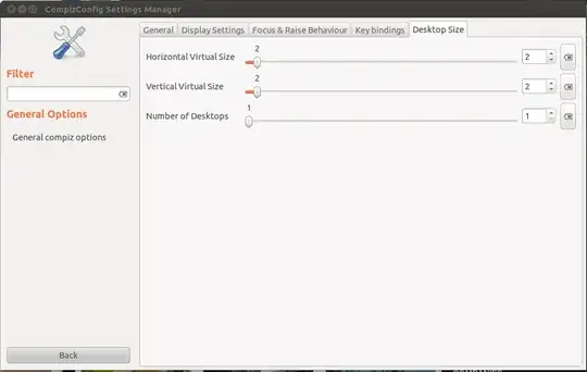

First you need to install compizconfig-settings-manager. The quickest way is from the terminal. Open a terminal (CNRT + ALT +T) and type:
sudo apt-get install compizconfig-settings-manager
Open the newly installed compizconfig-settings-manager and under "General Options" set the desktop size to 2 horizontal and 2 vertical, it should look like this:
screenshot compizconfig-settings-manager
Note that you should be careful with compizconfig-settings-manager you can break your system if you do not know what you are doing!
