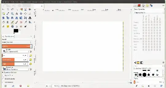

If the hardware is properly installed next step is to tell GIMP about this input device. I have Lenovo ThinkPad X230 Tablet with Ubuntu 16.04 and I have not installed any other additional drivers. I've just tested the instructions from this video on my tablet and now the pen works with presure. The steps are:
1. Open GIMP and go to EditPreferencesInput DevicesConfigure Extended Input Devices...
2. On the left side into the opened window will be displayed a list with the alternative input devices. Find and select your device.
3. Then on the right side click on the drop-down mode menu and select screen or window. Then click on save and close the preferences window.
4. Now you can use this device. You can setup its behaviour by the GIMP's feature Paint dynamics.
