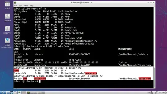

It is even possible to use UDF in the casper-rw partition of a persistent live drive, illustrated by the following screenshot of Lubuntu 16.04.1 LTS,
