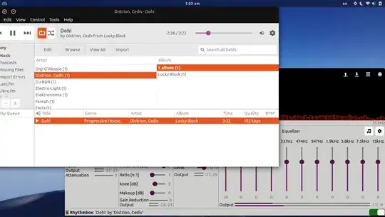

I have been using GNOME on Ubuntu 17.04 for a while now, and I never experienced such a sudden problem.
Some windows now are dimmed like if they were unresponsive. Here is a screenshot of Rhythmbox and PulseEffect open: Rhythmbox and PulseEffects open You can notice that the PulseEffects Window is dimmed. This also happens to Files (Nautilus), Terminal (GNOME Terminal), Videos (Totem), and Photos (Eye of GNOME), System Settings, and many other windows, but not all of them, so for example Rhythmbox, Google Chrome, Firefox, and Blender are fine.
This happened after I installed some software updates from the Software Updater popup, but I cannot remember the exact updates. Also after installing these updates, the GNOME on Wayland option disappeared from GDM3, which makes me think it is a graphics driver update that is causing this.
I am using GNOME on X (it should be obvious since I mentioned GNOME on Wayland is not available).
Any ideas? Thanks in advance.
