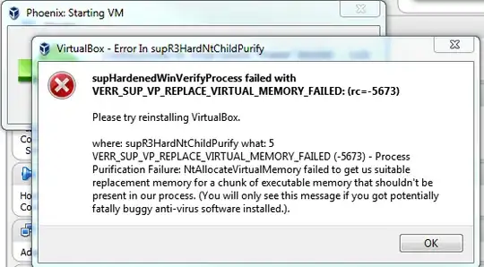

EDIT This isn't a duplicate of How to install VirtualBox Guest Additions for Ubuntu 16.04 because that says to install the latest version of VirtualBox. Here's the error I get when I installed vbox 5.1.28 and try to start one of my ubuntu VMs:
AFAIK Where I work no-one's ever succeeded in running an ubuntu VM on a version of VirtualBox > 4.3.12. Possibly due to a clash with corporate antivirus software as the error implies. Also, I first need to be able to interact with my VM via mouse or keyboard before I can install Guest Additions.
