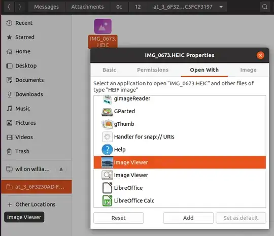

then find an HEIC file in the file manager, right click, select Properties then Open With and select Image Viewer (if there's two of them, select the one with the more colourful icon) and then select Set as default (or Add if that's the only option.) example of setting the HEIF MIME type

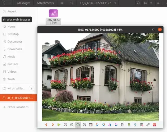

After that you can double-click HEIF files to view them:
example of an HEIF image opened from the file manager
