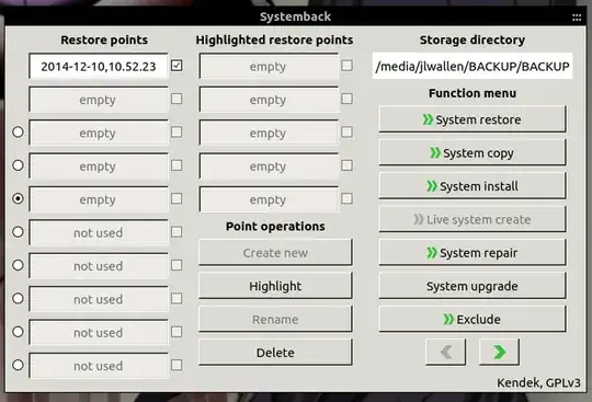

Using Systemback is quite easy. From the main window (Figure A), select the location to house the ISO image (by clicking the ... button under Storage Location).
Figure A enter image description here Figure A
The Systemback main window.

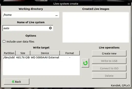

Click the Live system create button and, in the new window (Figure B), give the live system a name, change the storage location (this location will need to have more than 4 GB of available space), and click Create new. You can optionally include user data files by checking the associated box.
Figure B enter image description here Figure B
Creating the live ISO image.
Note: If your .sblive file is larger than 4 GB, the conversion to a ISO is not possible. This is a file system limitation.
Depending on the size of your installation, the process will take some time to complete, so grab a cup of coffee or administer a server or two. After it's installed, you should find an .sblive image in the defined storage location ready to convert to ISO. This image can either be written to a USB device or used to create a live ISO image. From the Created Live images window, select the image you want to convert, and then click Convert to ISO. When this process is completed, you'll find the .iso file in the storage location ready to be written to disk. With that disk, you can then install the live image on other machines.

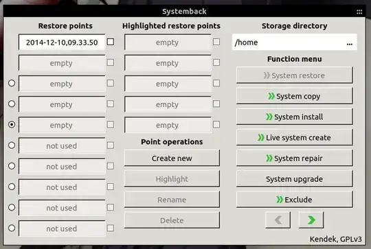

The best time to use Systemback is on a close-to-newly installed system. This is simply because of the file system size limitation. If you've installed too many applications on the system, the size will reach beyond 4 GB, and you won't be able to convert it. You can, however, still create restore points for a system. To create a restore point, first make sure you've selected a Storage directory, and then click the Create New button.
Once you've created a restore point, you can then go back to that restore point by simply selecting it from the left side of the window (Figure C) and then clicking System Restore on the right side.

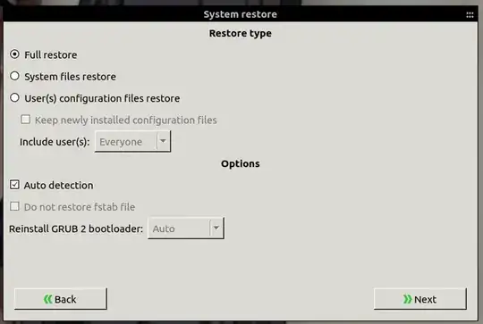

In the resulting window (Figure D), select the type of restore you want to do, if you want to include user configuration files, and click Next. This will begin the restore process.
Figure D enter image description here Figure D
Restore point options.
