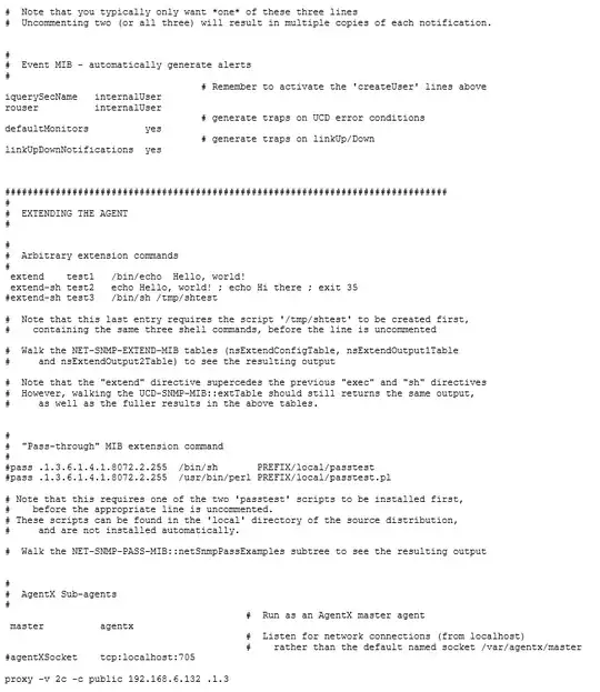

I setup as well as an agent as an manager (manager was unnecessary) on the Linux Device as specified here.
As far as I know, this can simply be solved by using a proxy. This is why I added the line
proxy -v 2c -c public 192.168.6.132 .1.3
to my snmpd.conf file.
However, when I do a SNMP request from my laptop, to my Linux Device. I get:
No Such Instance currently exists at this OID
Agent response reported an Error Status of NoSuchName
Apparently my SNMP request still looks for the OID at my Linux Device, which isn't a Printer and therefore does not have the OID I am asking for.

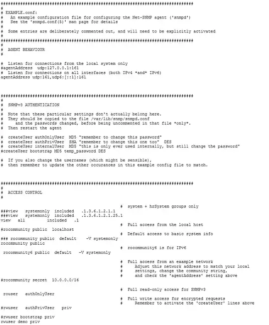

I am able to do SNMP requests from my Laptop to my Linux Device, and from my Linux Device to my Printer. However, I want the Linux device to just forward the requests to my Printer. I do not want any SNMP requests for asking OIDs from my Linux Device itself, only the Printer. Preferably I would like to just use the 'public' community. Can anybody help me out? Below you can find the most important part of my current snmpd.conf file.
snmpd.conf_1 snmpd.conf_3
