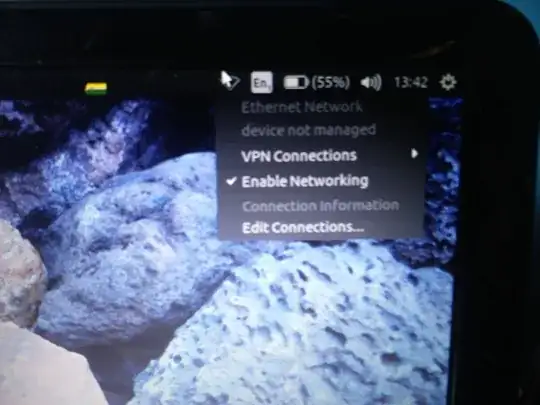

I have a Ubuntu 17.04 machine. And Wifi option is not visible. It worked before. I tried following commands.

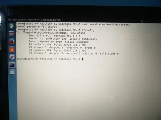

sudo service networking restart
sudo service network-manager restart
And the ifconfig command output as follows.
