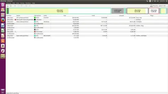

For your edited question:
I'd do like this:
Be prepared to reinstall ubuntu if anything wrong happens.
You don't need 15 GB of swap space. Take 300 MB from sda6 and combine it with unallocated 694 MB and make that partition swap.(1 GB) Combine balance sda6 (15.88GB (less) 300MB that you have taken in the above step) with sda5 (ubuntu partition) 15GB swap is a waste of space. When you boot to ubuntu, if you don't see the swap partition, reinstall ubuntu or check for any other solutions to force ubuntu to detect the modified swap.
If you combine the space you freed from windows c drive, you will mess up with the position of recovery partition, which might make it not possible to load recovery or diagnostic tools.
I have not tried modifying diagnostic or recovery partition. So I don't know about it. This article https://www.partitionwizard.com/partitionmagic/delete-recovery-partition.html says it is ok to delete recovery partition.
But if you take the swap space, you will get a lot of space for ubuntu. Decrease swappiness setting for better performance. It will force ubuntu to use more RAM and less swap.
Boot from the usb drive you made bootable to install ubuntu There is a software called gparted in it. If you can't find it, install it from the software centre. Open it and there you can resize partitions. Alternatively, You can download iso file of partition resizing tools like EaseUs , make a USB bootable with the ISO, and boot from it. You can also use Hiren's Boot CD iso. There is a partition manager in Hiren's Boot CD (without booting into mini windows xp mode). If you plan to use mini xp mode, scan and remove viruses from the iso using an antivirus before putting into USB.
If your partitions aren't near to each other, (say, you have a partition used to store movies in between your windows and linux partitions, use the unallocated free space to increase the space of the middle partition. Then shrink the middle partition to get free space on the other end of the middle partition. Then extend the space of ubuntu partition

I had the exact same problem and I was looking through the internet to find a valid solution. After all what I did was the following:
I booted windows and used a disk management tool (without paying anything) to move my unallocated space to the right. So in the above image we need to move the unallocated to the right of the linux partition. Then we have to wait a bit for the process to be applied.
Then you open ubuntu and go to Disks you press on the Linux partition and then resize. You will be allowed to resize and get the previous unallocated space.
