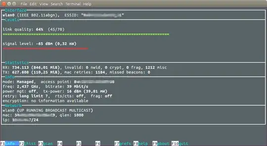

114
wavemon
A console app with color display and lots of easy to read information.
To install it enter the following commands:
 sudo apt-get update
 sudo apt-get install wavemon
To run it enter:
 wavemon
wavemon in action
