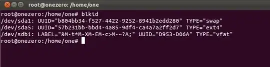

The easiest way
sudo -i
blkid
then plugin ur usb then run
blkid
before Usb
After Usb Plugged-in
so now i know my usb is vfat & its sdb1
if its auto mounted and u want to mount it manually 1st run umount /dev/sdb1
now manually mounting
mkdir /media/myusb
or make a folder where u want to mount your usb
mount -t vfat /dev/sdb1 /media/myusb
now usb has been mounted on /media/myusb
