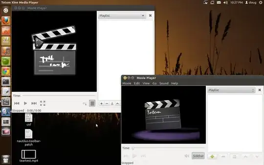

Simple - you can't, at least not without altering the source code. Vlc is an option if you have need to run multiple instances.
As far as 2 totem instances - the only way I see is to use 2 different versions of totem, here I continue to keep a self-built totem-xine around, in that case both can run at the same time
