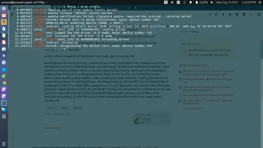

Problem 2: nvidian driver never load on kernel during bootup due to some missing key.
Problem 3: Some error like:-
nvidia-nvlink: Unregistered the Nvlink Core, major device number 245

The solution to my problem Number 2 and 3 are that I have installed modprobe. cuda is installed via old ubuntu software center.
I have also fired " sudo modprobe -m "
How to install nvidia-modprobe
http://manpages.ubuntu.com/manpages/wily/man1/nvidia-modprobe.1.html
Now my driver is getting loaded in the Kernel.
Now I am able to use it without much problem.
