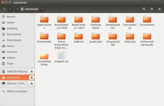

On Ubuntu Side
I can see the files with tree command and using browser I can see the folders. Folders of ADATAHD

HERE the tree command result on my to be recovered Hard Disk (some files are erased in the result saving characters on this question).
ubuntu@ubuntu:~$ tree /media/ubuntu/ADATAHD/
