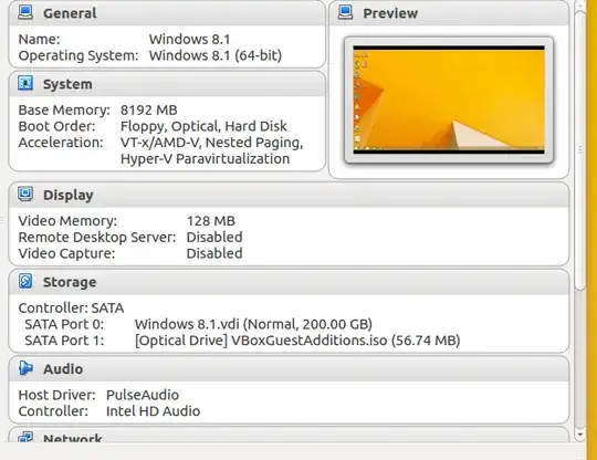

My VM system is,
Windows 8.1 Pro Installed Memory: 8.00 GB System type : 64-bit

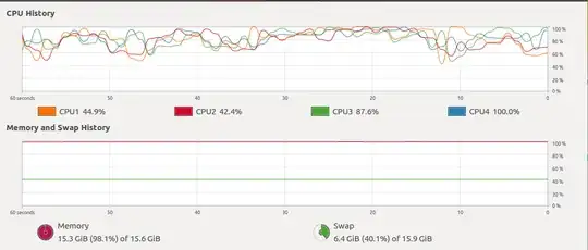

When running the VM, my system performance looks like the following graph,
And the configuration of my VM is, enter image description here
My machine runs really slow and the fan is much noisy than normal. By the way, my Windows is idling without running any program.

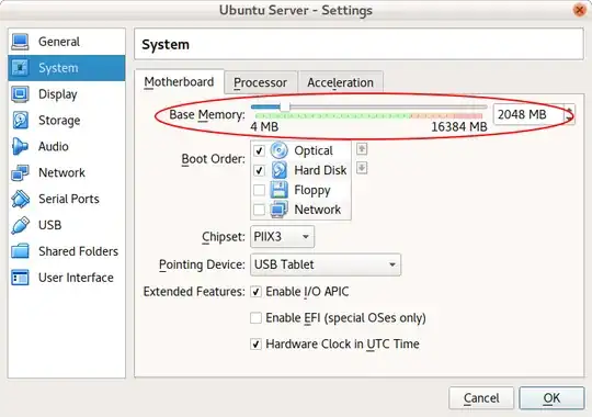

In the guest OS settings, by setting CPU=4 you've committed all of the CPU resources in your computer to the guest VM. Host operation will slow to a crawl. Generally speaking, you shouldn't commit more than half of the number of physical CPUs to a guest VM.
In the guest OS System settings, set the memory to 2048 and the CPU's = 2.
