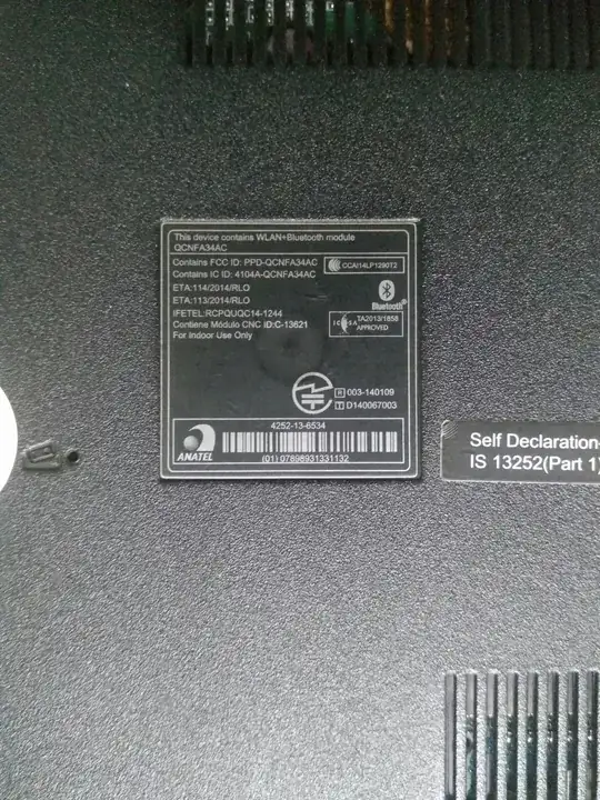

I have dual booted Windows 10 and Ubuntu 16.04 LTS on my Acer Aspire V 574 G. The bluetooth works fine in windows 10 but herein ubuntu the bluetooth setting says adapter not found.
And there is some information given on the back of the laptop that it has a WLAN+Bluetooth module.
