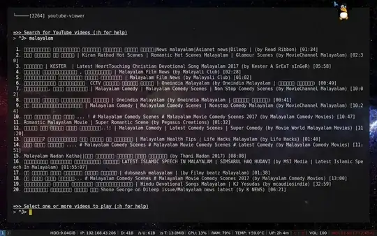

I have installed youtube-viewer in my Ubuntu 16.04 minimal desktop. When I am running youtube-viewer, malayalam results are not showing correctly as you can see in the screenshot below. I have tried the same in rxvt-unicode with malayalam fonts installed, but no difference at all. Any help would be appreciated.

Install Google Noto Fonts for Malayalam. That might help
https://www.google.com/get/noto/#sans-mlym
Also, do you have any Malayalam fonts installed already ?
SMC has a repo for Ubuntu. See if it makes any difference
https://launchpad.net/~smcproject/+archive/ubuntu/repo
